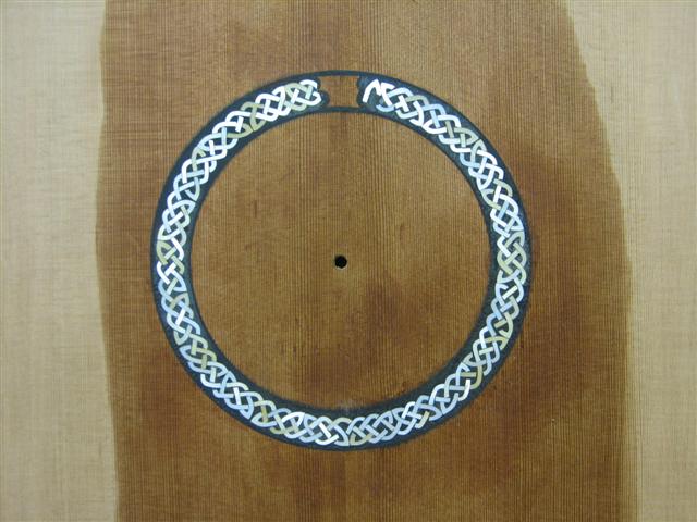

Well, I'm not very happy at all with the way this Celtic rosette is turning out.
I certainly don't like the epoxy. It's not getting hard enough. I've let it set now for 4 days, shop temperature is 22*C (72*F) but I can still quite easily indent my thumb nail into it. I would think that it should be harder than that. When I mixed it, I was careful to mix 1:1 as the container stated. I'm using the G1 epoxy from Lee Valley and it says to use it at or above 20*C so I should be good.
Anyway, I've been working at leveling the rosette and the epoxy is curling up on me. If I sand it, it smears and leaves big holes. If I use a scraper, it gets to hot and pulls it up.
Needless to say, I'm very disappointed with the whole thing and really feel like throwing the top at the wall. I haven't done that yet, but getting closer.
To boot, since I've tried to level this thing out so much, I've sanded through some of the gold on the MOP and now it's a white and gold MOP rosette instead of all gold .
Anyway here it is, in all it's ugliness. I think I will call up Andy and get another one, route this one out, inlay it properly and fill it all with ebony dust and CA.

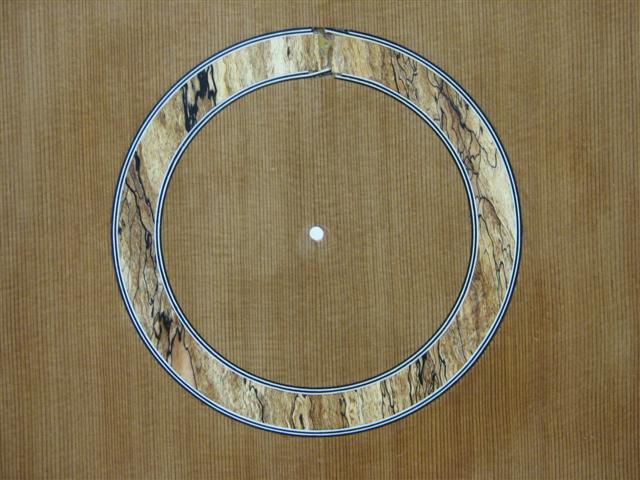

And here is the spalted maple rosette. I'm 99% happy with that one.

Rod,
You have an epoxy problem. My thoughts, the product is old, the proportions are not quite right (it is not that sensative though) or the 'black' has impacted the glue. I have used Cold Cure and now for the past 15 years have used West System and have never had it be anything but HARD.
You could try dropping some of the hardner on top but I doubt it will work Also, if it does not dry then you have a mucky mess to clean off the top.
I hope you get it figured though!

Put it on the shelf and make another. You should be able to pick it up in a month or two and be good to go. If the epoxy has set up hard enough that you have to dig your thumb nail into it to make a mark, then it should set up all the way with time.
You just need to wait until the cross-linking is complete. The epoxy is either old or you got the ratio's wrong (who hasn't done that). In this case patience will solve the problem.

After a couple of pieces of pizza and a beer and a good night's sleep, I'm much more calm about the whole thing. I will let the celtic top sit for a month or so to see if it gets harder.

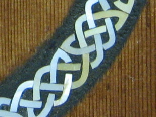

See how it's pitting in the epoxy, this just keeps happening, so I hope it will harden more over time.
Anyway, thanks again my friends for all the support and encouragement, your all wonderfull

the set times for epoxy are probably for joints that fit tight like any wood joint. Of course your not using it that way but as a filler. Now I know I do the same thing sometimes and it seems that patience is the key. It will eventually harden and you'll be good.

I have had the same problem with epoxy. To help it harden, I placed the top
in my oven at 175 degrees and let it sit there.   Low temp only.
Now I test my epoxy first. Mix a batch and see if it hardens. If it doesn't I
get new epoxy. My most recent rosette. (Posted above with "Hesh inspired"
I used cocobolo dust and superglue.
Good luck
